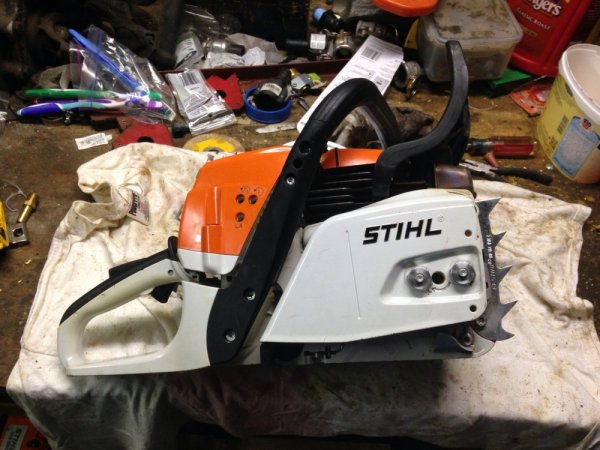

  7. Chvymn99
    19,280
    98,779
    Well the mS362 just got cleaned up. She's going towards Terry, for the work over. :D....

  8. Certified106
    Certified106
    4,170
    11,885
    In The Hills
    That's gonna be nice when you get it back!

  10. HoneyFuzz
    HoneyFuzz
    Jan 20, 2014
    4,263
    13,383
    Northeast , Ohio
    Cleaned up just fine...cant wait to hear how the mods go !!

  11. Chvymn99
    19,280
    98,779
    Yep, I try to keep them looking good after using them. Want them to last.
    Yes, I can't wait to see how it responds to the port job & mm. Hopefully in a couple weeks. But it depends on how his situation goes. Family first and I've got other saws to play with....
