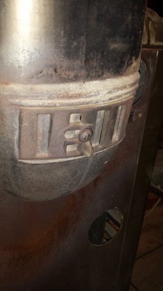

    I recently bought this Monarch wood stove off of my 96 year old uncle.
    I have a couple of questions that I wonder if anyone can answer. This wood burner has 3 drafts on the stove and a flapper on the first piece of stove pipe. Scotty said that the flapper was a barometric damper. I just put the damper in because that's how my uncle had it. Should I remove the flapper?
    Here are the pictures.
    A damper on the back of the stove pipe that is a part of the stove itself. 20161230_191243.jpg

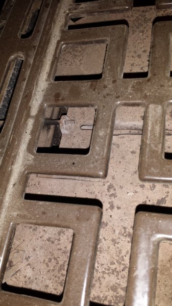

    A damper on the top of the stove.
    And of course the one at the bottom of the stove I know what that's for, but the other 3 have me confused? :faint:

    Don't know much about the barometric damper. I'm pretty sure that at least one maybe both at the top are to use when you have a nice hot fire going to roll the flue gas to slow it going up the chimney. My very first stove was a warm morning stove and it had a single top draft besides the lower draft that fed the fire.

    I'm thinking all the extra dampers would have to do with the coal burning option?

    Scotty is right about that "flapper", it is a barometric damper. Looks like a Fields brand. It would need to be there to burn coal, high draft with a belly full of hot coal = meltdown!
    The "baro" needs to be plumb/level in all directions and then adjusted with a manometer (loosen the "knob" (weight) and then slide it forward or back to get the setting you need) this is done with the stove hot. Often times those old coal burners called for -0.03" WC draft.
    Looks like unc knew what was up...having both types of pipe dampers...I do the same thing. Using the baro for burning wood causes creosote buildup due to the cooling of the flue gasses, so I cover it up with HD tinfoil while burning wood, then just use key damper to set the draft. When you want to burn coal (or oil in my case) open the key damper up and pull the foil cover off to let the baro work.
    As for the dampers on the stove itself...I dunno anything 'bout that...

    In that case I'll keep the barometric damper because I will also be burning coal. Thanks for the info!
    One down and two to go. Now if someone could just tell me about the draft on top of the stove and the one on the back of the stove pipe itself in picture #2? :sherlock:

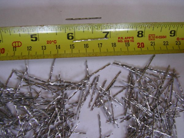

    Clean the burn chamber and cast it right in the stove. You want to mix it so you can toss a ball of it between your hands without the ball falling apart just a little slump .
    Next comes the curing stage. Pay attention to the section on curing the refractory in the thread below, and you will end up with a good product. I also add stainless steel needles to the mix to give the refractory more strength .

    These are the refractory stainless steel needles. They are mixed at a ratio 1 1/2 to 3% of the mix. Sort of like rebar for the refractory. If you decide to make your own bricks I will send you some.
