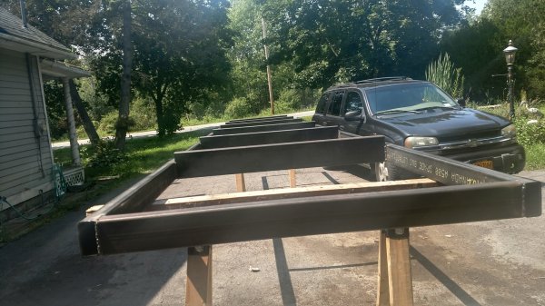

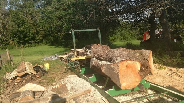

    Finally made my mill mobile ready, and a good bunk setup. Ordered some 24' 3/16 tube and stuck it together.
    No more leveling the track and fussing everytime I want to mill.:banana:
    Bad news is the bunks hit my arch hitch, instead of backing the arch over I have to side load bigger stuff...
    Sits on 3/4 inch threaded rod on each inside corner of the crossbeams. With two nuts welded to the inside corners for leveling, With scrap plate as feet. I'll probably end up doing 6 harbor freight trailer Jack's instead at some point.
    I have no need to move the mill, but I have a 3500lb axle from a boat trailer that is bolt on ready.
    Harbor freight magnetic light kit and I'm good to transport. Mills fall under the same category as wood splitters as far as plates and registration(none required), surprising for NY. IMG_20170813_164652555_BURST000_COVER.jpg

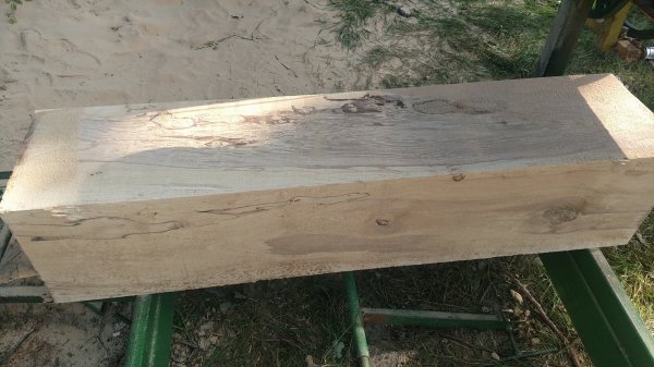

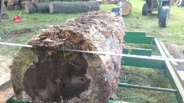

    Yesterday I fanaly got to try it out. Milled a hunk of beech, outside was punky good enough for 13" cant though.
    Milled some cherry silver maple slabs a small'r beech maybe 500bdf altogether.
    Did two truckloads of slab scrap, stacked on the porch with another to go, makes great shoulder season stuff.
    Busy Sunday!
    More milling tonight!

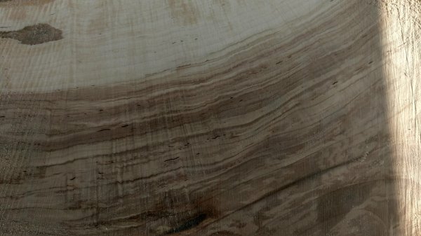

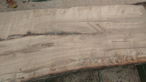

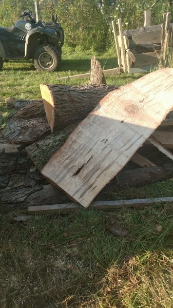

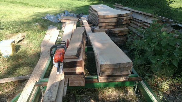

    Got some nice figured slabs tonight. Had to do some trimming, I usually pull the guides to slab at 40 inches but was lazy. These are around 36" wide and 3 inches thick around 6 feet long.
    First time I've seen huge areas of tear out just like a planer. IMG_20170814_174507417_BURST002.jpg IMG_20170814_181053598_HDR.jpg IMG_20170814_183345799_BURST003.jpg IMG_20170814_174507417_BURST021.jpg

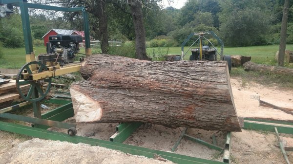

    Biggest hardest wood I've cut with it. Sugar maple.
    Those slabs are just about ready.
    When I first built it R&d on some old oak, used a go cart axle shaft.the shaft wasn't up to par... I've since upgraded, I forget the alloy. It's better to use 2inch shafts:emb: I used 1" cuz it's what I had.
    Budget build!
    If I could do it over I'd spend the extra couple hundred and use 2 inch shafts, my bearings and wheels are all 1". The drive pulley and band wheels would need to go to the machine shop, along with new pillow block bearings in order to do it.

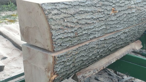

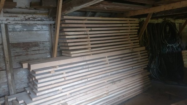

    Milled a few hundred bdft of hemlock. True two buh sixes.(for a maybe solar kiln) IMG_20170819_145357147_BURST000_COVER.jpg
    1/4 sawed a portion of oak glad I did because it had a little tension in it. 3000lb log tested my new bunks!

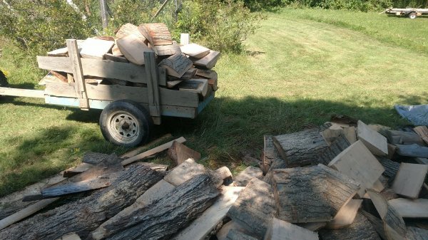

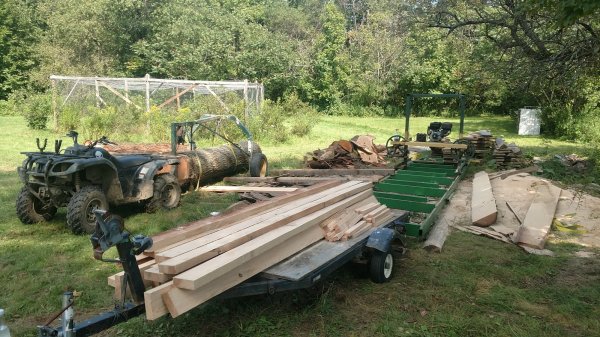

    Did some stacking over the weekend! IMG_20170827_124329641_BURST000_COVER.jpg
    And more picking up and stacking! Have a good cord ++ of waste wood! IMG_20170827_150003738_BURST000_COVER.jpg

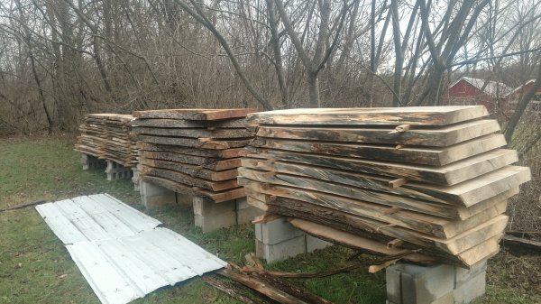

    Slabs I'm trying to set up to slow dry over winter. Sell'em next year. Trying to Build a small inventory it all needs time to dry!
    In a race against myself to get a bunch of logs done before winter.

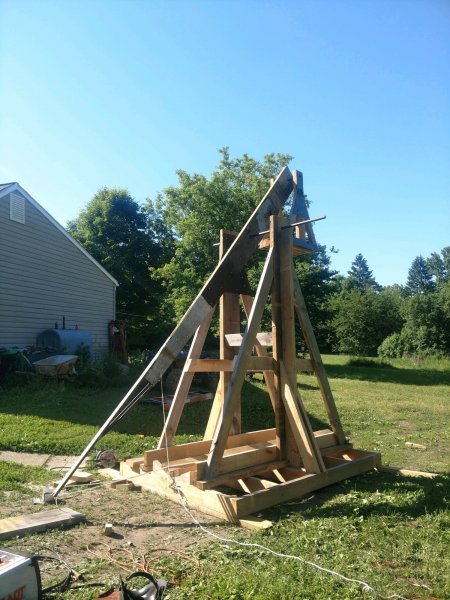

    And some of the milled hemlock was used for a almost no cost trebuchet build.

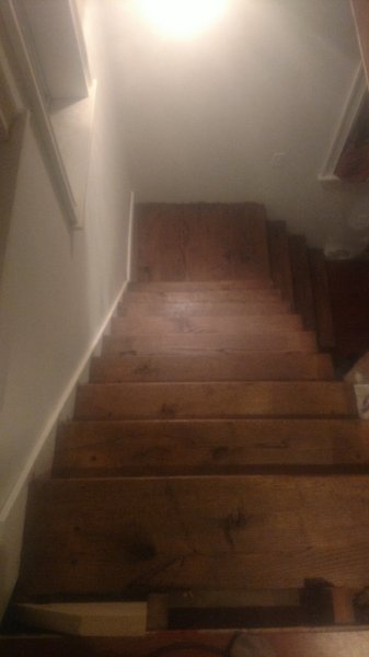

    Rebuilt the stair case with some of that oak.
    New stringers treads and risers...
