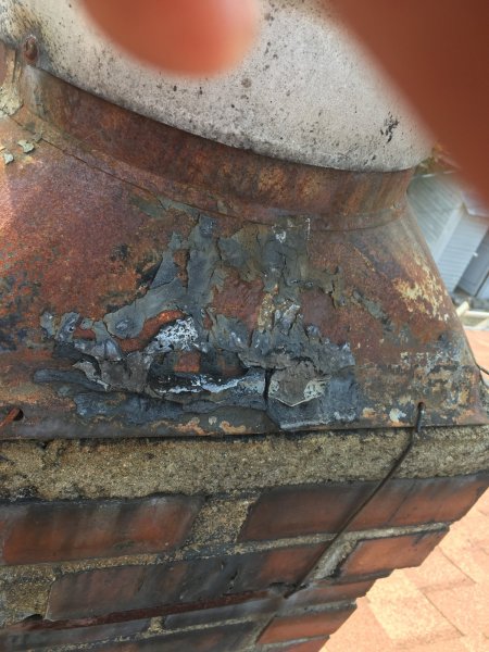

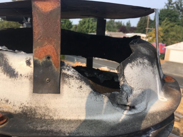

    IMG_2763.JPG IMG_2765.JPG I got on my roof today to get the moss off and took a better look at the top of the cap. Not sure what happened but if this is severe enough, let me know. Just a reminder there's nothing being connected to this chimney, but this concerns me as an integrity deal.

    Looks like it's rusting out more than anything. When was the last time it was used?

    I really couldn't say because when I moved in, the chimney was all walled up to begin with. But take notice to that melted part on the top?

    Oh, ok...I see now. Didn't notice it the last time I looked, I thought I was looking at galvanized coated steel. Wow, that aluminum is melted pretty good, Id say at one time or another there was a flue fire.

    Yeah I am glad that they sealed it up but this just takes the chimney to a new level that I don't even want to begin to use it and it will likely come down.

    You could always install an insulted stainless liner, if you intend to use it that is what I'd do. But you'd want to put a camera down it first to look at the internal integrity.

    Stick a hand held mirror in there and check the clay tile (if there is clay tiles) if you had a chimney fire, the tiles could be cracked.
    All that galvenized stuff needs to go. If you have room, run an insulated liner down that thing. If no room, you'll probably have to break out that tile, then run the liner. Once the liner is in, pour a new crown.
    Or like mentioned, delete the chimney and run class A out.

    Looks like a chimney fire to me.
    Not really sure what you are asking but if I am following correctly, you do not intend to use the chimney, you are just concerned with its structural integrity..... or, will it fall off the house? If that is the question, the mortar and bricks look pretty good to me, and it depends on what is under it. If all the brick and mortar joints look like what is shown in the photo, and the flashing is intact and lying on the top of the shingles correctly, then I would say it should be fine regarding any weather or any other normal outside events.
    Even as a chimney, if the liner is good and that rusty cap replaced, it would probably serve for many more years. I would inspect it internally (Easy Boys! we are talking about the gentleman's chimney here!) carefully but as long as it is tile lined, all the tiles are there and there are no voids between the tiles, again, I would say it would be fine to use.

    Hey FatBoy85 , no expert here but the house we recently moved into had 2 woodstoves both caked with creosote (moved in before we planned to, no furnace, wood stoves only so we had to use them). Turns out there was a creosote problem on both woodstoves here, the cat one was actually backflashing from the stove (worst was the door) when I opened the door to stoke it. Though we had it "professionally" cleaned, we ended up with many large chunks that were shiny like glass after cleaning the chimney ourselves. AND, after we took that stove out, the inside of the stove looked just like your pic of the creosote bark minus the rust. That "bark" was what was igniting and backflashing me. My previous use was on a pipe that we were militant on brushing (sweeping) but it was always only flyash since we always used dry wood..,.. this inherited and neglected chimney took chains to break the creosote out of so we could put an SS liner in. Better safe than sorry, looks dangerous to me either way. Clean the chimney (chains if needed) and line it, and scrape all the creososte bark off inside the stove.

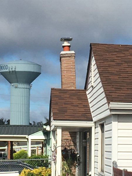

    Side note: neighbor next door has a fireplace I think of some kind. But the scary dang thing is their chimney. It comes out looking super crooked. I mean I look at it and its like an accident waiting to happen.... dunno if it was built same time frame as mine but it sticks out of the house and I just get a little bit of a laugh out of it how it looks wants to fall over.

    Yea, chimneys aren't as stable as most would think. Just a simple lean against one towards the top is enough to bring it down.

    Tried putting this as you best see it with the straight base up against the house then the ....considerable lean. That's like off about 15°. If it was straight it would likely line up with the small threashold roof and the edge of the house roof.
