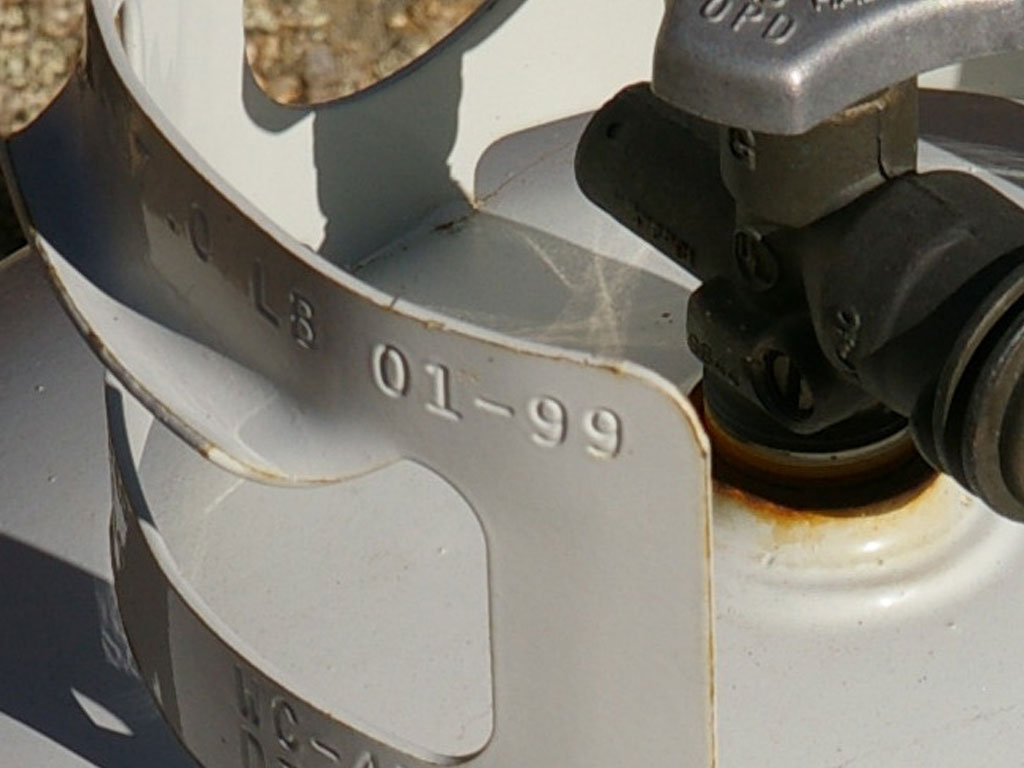

    I got my BBQ tank filled around 2 weeks ago. They have never checked the date. Usually crack open a screw on the top to fill, not sure if that is normal? They put 4.8 gals in it and it was about $20.
    I just went and checked my tank out of curiosity and it has 01-99 manufacture date. :whistle: I'm actually suprised cause it looks almost brand new. Looks just like this:

    Nate. The screw is just a bleeder valve. As the tank gets close to full, you open that valve a half turn or so and when propane starts spitting out, she's full.

    If you're getting LP out the bleeder, you are a little beyond full, lol. The bleeder is really only necessary if the tank needs to be purged.

    Dunno, they fill till liquid comes out if that.

    The stem of the bleeder drops down the tank a few inches. When LP comes out at the screw, it means your tank is "full" while still having the necessary headspace. Now, if you don't use the bleeder and get LP coming out at the main valve, then you know it's at true full......bad idea.
    edit: the OPD valve has overfill protection built in as well. The main reason propane dealers can't/won't fill bottles with the old valves anymore.
