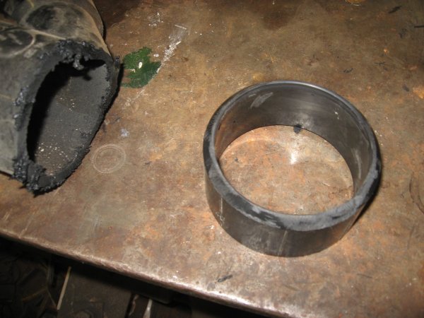

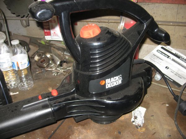

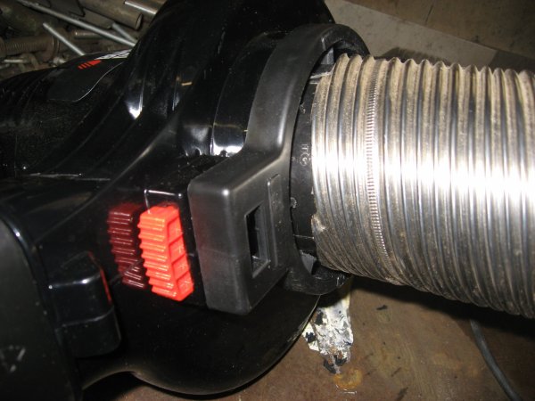

    3" adapter i had kickin around,cut the flange off it and cleaned it up,dremmel a slot in the ribs and glue it on,fits my 4" pellet liner perfect(saved my cutoff so i wouldnt have to keep getting on roof to size it) IMG_0548.JPG IMG_0549.JPG IMG_0550.JPG IMG_0551.JPG IMG_0552.JPG IMG_0553.JPG

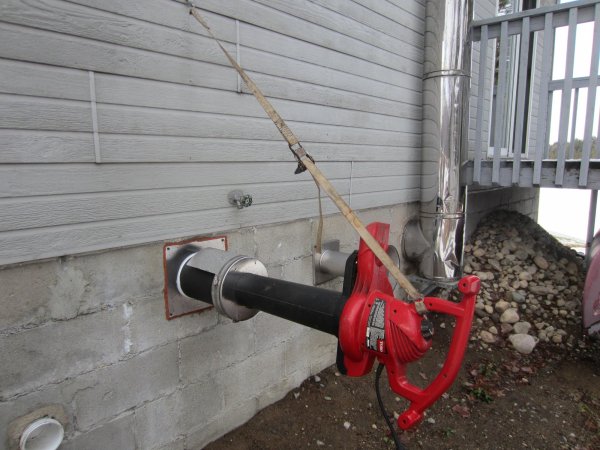

    Here's mine made to fit the Selkirk DT/DT-M vent. I just removed one of the split vacuum barrel and it fit just a tad loose on the vent. By anchoring the LB against the wall, it sits snug against the back of the vent. If it not keeping a good seal I will add some soft rubber foamy material at the end of the intake barrel which will compress against the back of the vent.
