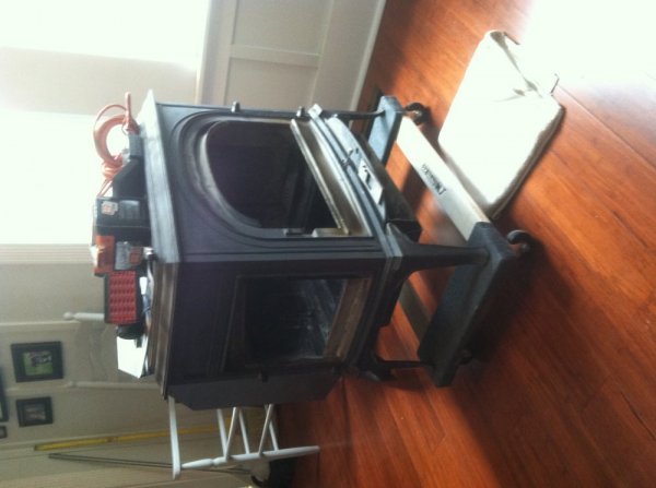

  19. My IS heats my home
    My IS heats my home
    Dec 1, 2013
    7,394
    17,637
    Albany, NH
    image.jpg My stove is work release. Working on the air intake problem.

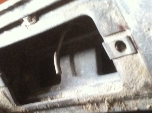

  20. My IS heats my home
    My IS heats my home
    Dec 1, 2013
    7,394
    17,637
    Albany, NH
    image.jpg This is where the dog house would go. The lever would control the slider over the air intake here. All seems ok
