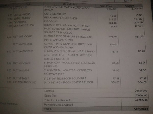

    1) Anybody know the MSRP of these, matte black with front and bottom heat shields?

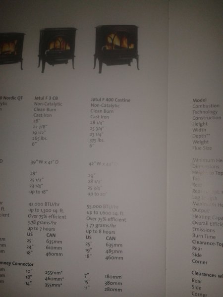

    Prices (above) based on my purchase 3 years ago. Firebox is 1.5 I believe. It will hold a 20"log max (E/W) and only 6" (N/S)

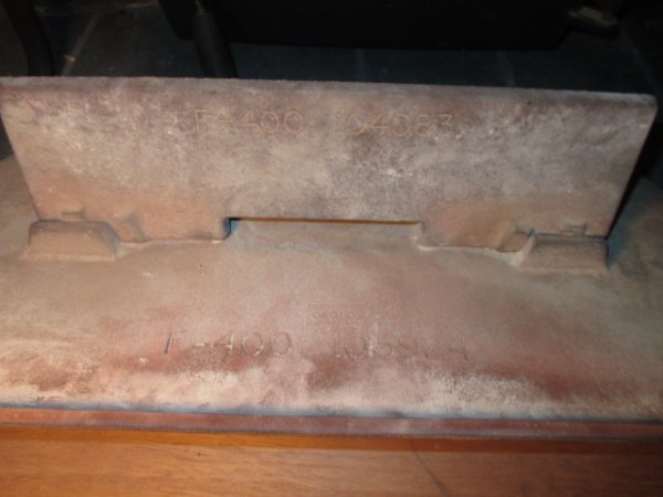

    The Castine needs a strong draft as Well Seasoned said. I am running about 23 ft of interior chimney with an insulated flex liner. I get a little smoke spillage on a day where the temp is in the 40's. Above the secondary combustion chamber, there is a plate for a baffle, I would assume to slow the exhaust path down to get more heat out of the stove. Here is a pic.
    So the vertical plate is in the path of the exhaust, which seems to explain why there are drafting complaints.

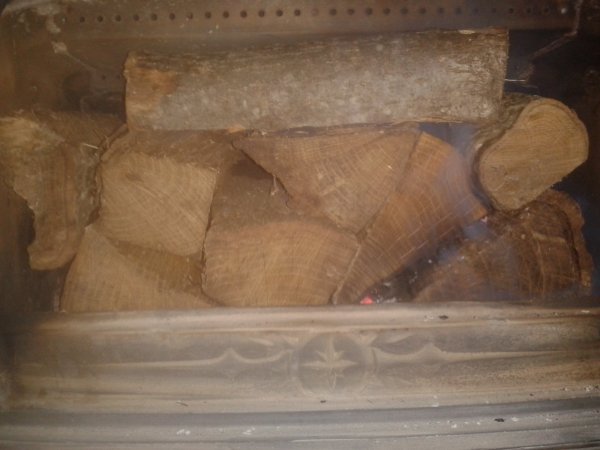

    mike bayerl I usually load N/W, but shorts are inevitable with all the cutting I do. When I cut shorts,I keep 'em around 6"to fit the stove N/S.
    Currently, it's 15°F out. The high for the day, last night it was 4°F with w wind and tonight is going down to 7°F
    The castine has a medium fire box, so packing it as tight as possible goes a long way.
    Tonight, I'm burning 3 year old pin oak. 3 years ago I wasn't the best splitter, and since, have perfected splitting rounds into nearly perfectly squared splits. Splits like this for next year and after will fit in the stove so tight, I expect longer burns, and higher peak burns. So next year I'll be using this stove for the fourth season and expect a whole new learning curve.
