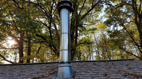

    Chimney pipe showed up so I can add another section to the chimney.
    Should make my 8" chimney draft a little bit better, it's been working fine I just think it could be a little better.

    I would have responded earlier but was adrift...staring at the new shiny!
    How tall is the chimney?
  3. HDRock
    17,160
    59,513
    Right now it's 15 1/2 ft, with 4 1/2' of 6" stove pipe

    Maybe our resident engineer or someone inclined in math can tell us the expected bump in performance % wise.:D

    It took some help from the forums and some research to figure out what I needed because there are no numbers or names stamped on these chimney parts, chimney was here when I bought the house, 25 years ago.
    Figured out it was Selkirk metalbestos,, what I bought was Selkirk sure temp and it fits perfectly:thumbs:
    Total above the roof 5' 3" I have one more locking band on the way, this chimney never had any of those on it, one came with the new pipe.

    Now it's 17' :) -wood-stove.jpg

    I might have to leave the windows open and fire it up :D

    We would be shocked if you didn’t. Give it a test run.

    Fired it up, so far I think it's doing a little better at these temperature is a good time to check draft
    I was able to close the door sooner, dial down the air a little sooner and is taking less air sitting than usual.
    Secondaries are doing good at a lower pipe temperature

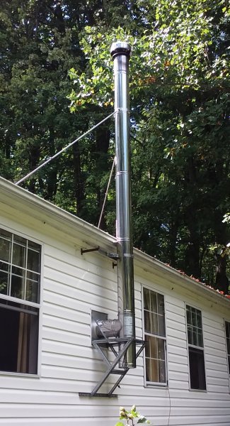

    Good going. I would like to add another section to my chimney but it would mean renting a scissors lift.

  17. papadave
    82,447
    How much for one of those?
    Would it be less to just buy a $100 extension ladder (or whatever they're going for)?

    My Chimney:
    papadave likes this.
  19. papadave
    82,447
    Ahhh yes, I forgot your setup.

    I think it needs several more feet if there's any hope for it to draft decently.
