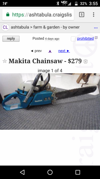

    Found this on CL. Bar was hot at one point. 155psi on the compression, they let me test before I bought. Starts, idles and restarts easily. RPM maxed out at 11,600. Paid 240.00 OTD.

    Looks cool. I love the dawgs on it! How many cc's is it?

    Ya did good, I paid $320 for mine.

    64cc

    Someone on here said what the difference is between the blacktop and the gray top, I don't remember what it was though.

    Nice saw for a great price!

    Nice saw at a great price . You’re gonna like it .You can turn it into an 80ish cc saw for about $200 ,and a couple of hours work .

    I'd say you done good.

    I think mine needs a Makita marked bar. It got hot! I'm betting someone didn't want to pay for bar oil when they rented it. Bar has some burrs and wear channels from the chain, plus the paint is gone

    The grey top is the non catalytic muffler, 6401. The black top is the 6421 catalytic muffler. I don't recall exactly when they discontinued the 6401 and started the 6421, but it may have been back in 2012 or so. Other than the muffler, and the color of the top, it's the same saw.
    Yes, these are a great pro saw, and at the smallest displacement of this family of saws. You can put a 73cc, a 79cc or aftermarket 85cc and maybe bigger too, and have more per to weight ratio. Muffler modding loses some weight too, and gives more power. As a 64cc saw, it's a bit on the hefty side, but it's a great saw that can be made even better.
