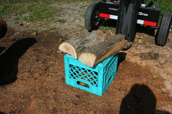

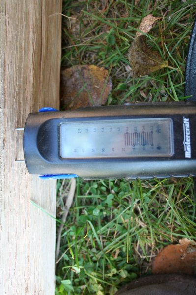

    While I was splitting today I dragged up a couple of pieces of Red Oak from my pile downstairs to check them with the MM. These are representative of most of my wood for size and I was careful to get pieces that had full bark on them.
    After splitting they both read 19% on the freshly split inside and 14% on the outside.
    So the one year plan that I'm on is working for me, the numbers don't lie. :D
