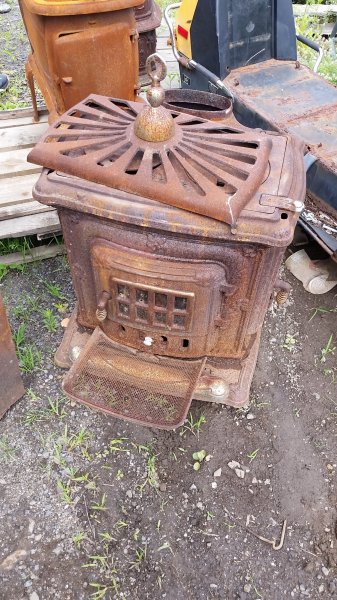

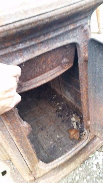

    Well, funny thing today. I hit the local scrapyard doing sone pickin, and I think they have your stove. I did a double take and went over to coon finger it.
    This one has the swinging panel on the side door. It also has a screen for open door viewing. There is a wood retainer across the front of the door. So I guess this is a top, front and side load. No baffle plates in this one. It is missing legs and the top front chromed bar. It has the foot bar down by the air intake. Here are the pics.
    Crappy outside view of flap.
    Inside view of the flap.
    Pretty neat swing away top. The two holes in the front corner is where the chrome bar would go.

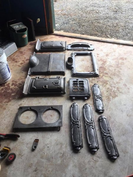

    Update: Gentlemen, here below is a photo of a majority of the parts now derusted:
    Most of the pictured parts were in the vinegar bath for some five or six days. Some parts were in the bath for just about three days. The parts do not come out of the bath looking as they do in the photo. I spent about ten hours today wire-wheeling them. I went through two 4.5" wire wheels, wearing them down to like an inch. For those who have not done this kind of a job, it might be easy to wonder what the vinegar did if I had to spend so much time on the wire wheels. Well, the vinegar 'frees up' the adhesion of the rust. Without the vinegar bath, it would have taken a few more wire wheels and a few more days of work to get them, maybe, as they are now. So, while they do come out of the bath looking almost no better than the way they went in, the rust now comes off much more easily. Note that the parts that were in the bath for just a few days took a lot more effort to derust than the parts which were in the bath for several days. Still, I would be lyin' if I did not admit that I feel like I was at the gym all day today! Anyway, looking at the parts, they are, to my eye, gorgeous. The parent iron, its natural gray tone, nice and clean. Pitting is, amazingly, minimal and hardly noticeable without putting an eyeball on the iron. I do not see any need for grinding or smoothing out any of the parts. She is now ready for some scotching/steel wool or sanding, and then stove paste. This stove was a rust-bucket when I started and I had some doubts as to her viability -or my skills, until just the other day. But I am managing to bring her back to life.
