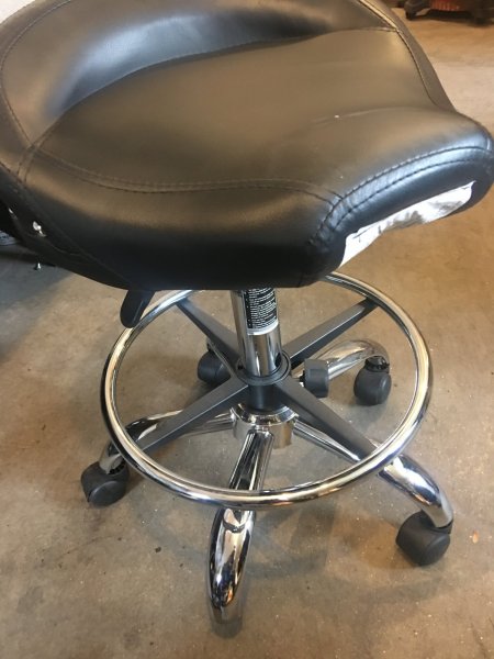

    It works great until the wheels start unwinding and then as you roll around the wheel falls off!
    Biker-Style Pneumatic Roller Seat
    After the 1st wheel fell off, I noticed one other was about to go and 2 others were loose! LOL
    If they included just 5 C type lock washers, it would not happen! I had to add my own!
    See pics

    Red loctite those bastages.

    And there is never enough room to get a proper wrench in that little space to tighten the nut down.

    Yes, That is True!!! The addition of the lock washer does make it easier to get the wrench in there too!!
