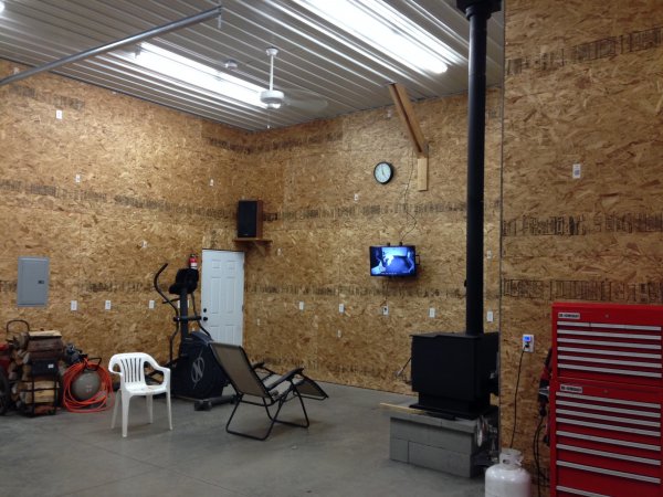

    What's the spacing on the rafters? 1x3 or 1x4 is fine if you're under 24" and not supporting insulation loads. 24" on center. They will go up FAST. I put white pole barn metal up inside my 30x60 shop using a sheetrock lift. Easy. I hit the bottoms of the rafters at 24" spacing and have loaded R-50 cellulose on top with no sags. Billions of screws and one trip to the eye doctor to have a little piece of metal pulled out from the screwing operation overhead.

    I was worried about that in my shop. No echos at all. It works really well. Maybe the ribs matter?

    I suppose rather than undercoating, I do have stuff on the back of my metal. Behind the metal is a layer of 6 mil poly sheet and then 15" of cellulose insulation. You get no rattle or tink sound when you tap the metal. Just a dead thud.
