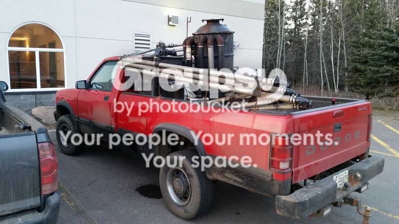

    A co-worker spotted this pickup last week in northern Ontario and couldn't figure out what was going on. I have only seen the photos. Could this be a wood fired gasification system?

    Either that or a still disguised as a pick up. :D

    I bet it is , sure looks like it, notice the blower

    I saw one of these on a show, cant remember the name of it but two guys picked a way to earn by doing milling the old way and a small truck was outfitted with a simple barrel and that was hooked up to the carb through the side of the truck and ran on just simple bark and scraps outside. Cant argue with free can ya?

    You can still get the us Govt. publication on gasification that was printed during WWII, its dated but the principals haven't changed. Bunch of U tube vids on this as well as other info. Wood gas much lower power factor than dino fuel- Don't know if it is possible to run it through injector systems on newer vehicles. I do know that you need a pretty decent method of filtering it before introducing it to an engine. There is a company up Alaska way that whole systems including storage.

    The fuel is actually low yield gas, essentially the combustibles in smoke from a fire that is not allowed enough oxygen to actually burn. The wood pyrolyses, the combustion products are siphoned off and fed to the engine, usually before the carburator. On the one hand, it is amazing that it works at all, never mind not too terribly badly. On the other hand, the gas is corrosive, and the solids in the woodsmoke will absolutely destroy and engine if not filtered out, and that is not easy or cheap to do. In the end, if or when there is no other fuel and yet there are vehicles, such as occupied Europe in WWII, then it is workable but otherwise, not worth the effort IMO.
    On the other hand, large scale gassification (think power plant) works really well and will consume almost anything that will burn, from sawdust all the way to wood and coal as well as the debris from both. The underlying problem with all these systems is that we still have a lot of fossil fuel and it is still very inexpensive; we like to think it is expensive when we buy it but really, it is cheap, plentiful and wonderful as a fuel.
    But all the way back to wood / charcoal powered vehicles: they are a fantastic novelty, just like steam powered cars. Beyond the practicality, they are simply cool. Wood gas does have a little danger to it because now and again it will ignite before it is in the engine but generally this only results in relatively minor damage to the pyrolysing vessel. Also, it is almost impossible to actually start an I/C engine on wood gas so they are started using gasoline then 'switched' over once running and a bit warm. Throttling is also a problem because the amount of gas generated is not instantly changeable or readily controllable as gasoline or diesel fuel is. But like a Stanley Steemer, it has an extremely high 'coolocity' factor. :)
