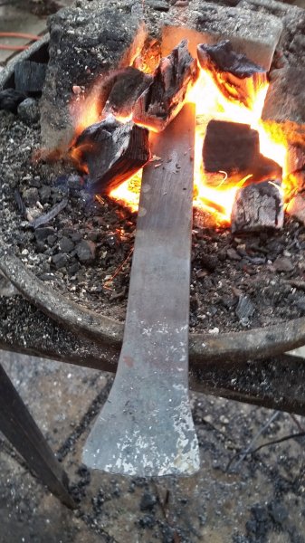

    The first one I started Sunday, the metal was thicker than I liked and I abandoned it. I picked up some 1/4" mild steel bar stock and tried it. I also forged out a tool steel bit that would be let into the head to take an edge.

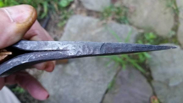

    The ends were peened out to a flare on each end. I located the middle of the head and bent it over a bick and carefully lined them up.

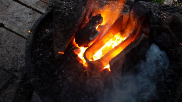

    After bending, the head was heated and coal mounded up for the forge weld. I could not get the tool steel to stick, so I went with just a regular forge weld.:headbang:

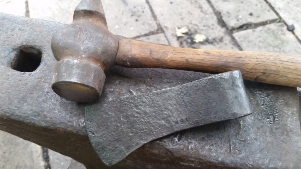

    It took a few tries to get the pieces stuck. It was a matter of easing up on the air to get to a lemon yellow color of the steel. Once I had the right air flow, she stuck pretty good after that. Not too bad, a small seam line.
    A little clean up and getting the eye back in shape, it took a coat of paste wax.

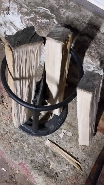

    I made a haft out of sugar maple and stained it up. I was looking for an 18" long piece of straight walnut to match the knife handle, but all I had were short pieces. I used the kindling cracker to get the maple down to size.
