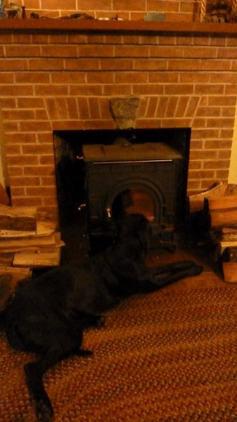

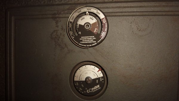

  17. Woody Stover
    Woody Stover
    1,261
    3,039
    Southern IN
    Yessir, and it ain't working too bad right now, either. And...it's pup-approved! :cool:
    I'm not a VC expert but I get the impression that the "Flexburn" system is different than the old "Everburn" (neverburn.) The video seems to imply that as well. He's saying the parts are more durable. I wonder how long ago they changed that? I looked at the manual...lifetime guarantee on all refractory parts with 5 years free labor. I'd like to hear from someone who's bought one recently...

    Is that a 2641? or a medium sized dutchwest?
  20. Woody Stover
    Woody Stover
    1,261
    3,039
    Southern IN
    2460, small convection. It's keeping up OK now, but I can tell that if it gets much colder, I'd better put the blower on it and fire it a bit harder, or get the Keystone back in there... :fire:
