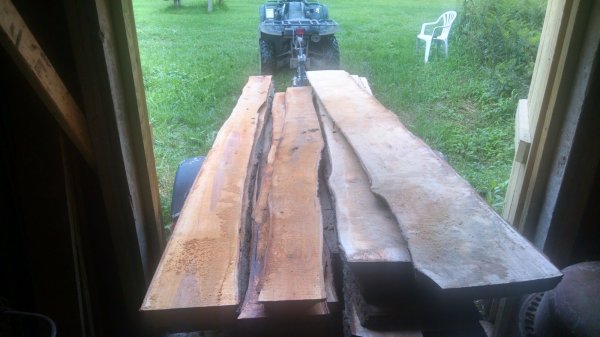

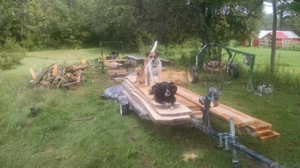

    Took down a big dead beech and this birch was a casualty. I think it's one of the heaviest woods I've handled.
    It has a nice color to it, smelled amazing.
    The pale stuff is some sugar I had.
    Didn't know what to do with any of it, so I just riftsawn it all. 16ft and the maple is about 15ft.
    Havta go back and seal the ends. IMG_20160816_163439171.jpg IMG_20160816_163312886_HDR.jpg IMG_20160816_154502404.jpg
    I let the trailer sit for the night before moving it Into the shed the next day and the tires were buried in the ground!

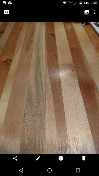

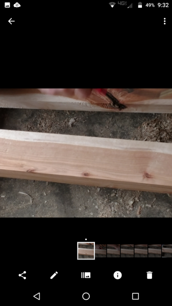

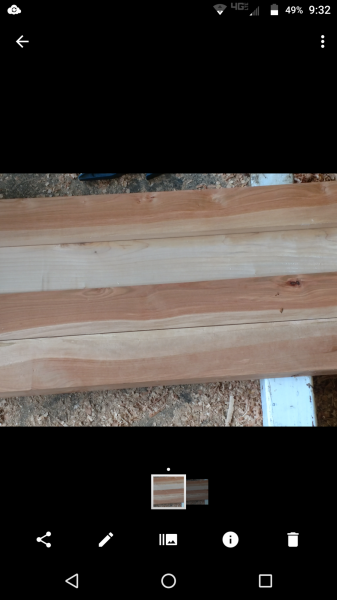

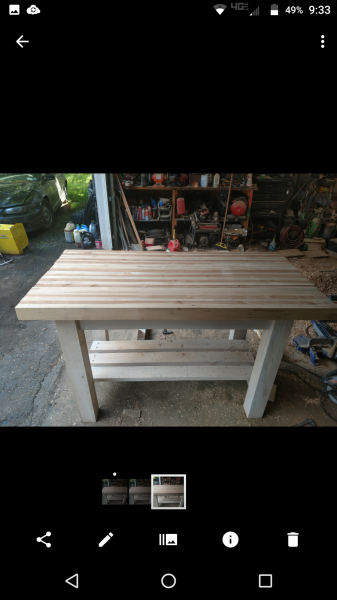

    Wood was 11-14% about a month ago so the Mrs and I made a table for the kitchen. White ash (4x4 legs)for the bottom and black birch(aka cherry birch) with a few sugar maple pieces for the top mixed in.
    Top is almost 3 inches thick 3 feet x 5feet. It's hefty! Screenshot_20170614-093259.png Screenshot_20170614-093249.png Screenshot_20170614-093321.png Screenshot_20170614-093309.png Screenshot_20170614-094608.png

    Oh that's some wonderful looking butcher block table there sir! Wow! Heavy set wood like that will turn that into an heirloom. Great for passing down. :thumbs:

    WOW! You are a masochist! Birch is very fussy about grain direction for hand planing. If you go with the grain, it rewards you with beautiful depth of chatoyance. Against the grain, it rips and tears out like crazy.
    BTW, GREAT table!
    p61 western, tamarack and Boomstick like this.

    It was a pain, that's why the sander was in the pic...making sure I can get out the small tear out:rofl: :lol:
