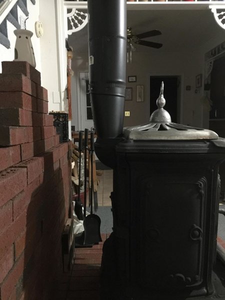

    HDRock, I have been checking with the laser thermometer. When the charge of wood is burning well, the cast iron sides average about 550 and the flue starts at about 250 right out of the stove and is about 200 by the time it goes out of the upstairs bedroom ceiling into the attic. If I were to damp it, I think the stove would be up at 600 or more -and that might be too hot, no? Right now, the room is about 80 deg.f. and the upstairs bedroom seems about the same. I don't stuff the stove. I charge it with about 4 pieces of wood at a time. So I think we are good.

    Do you check the top of the stove if the sides are 550 the tops definitely hotter than that..
    250 straight out of the stoves actually kind of cool, I run mine with the pipe about 350 when it's going no less than 300.

    HDRock, When the charge is burning well, the bottom halves of the sides are running around 550; the upper halves of the sides are about 400; and the top of the stove is around 350. The flue is from the upper back of the stove, offset. Flue usually is around 250 with the afore-mentioned temps. I am also surprised that the top of the stove is always cooler than the bottom. /// At this moment, it is 39 deg. outside. Before I fired up the stove, it was 60 indoors. An initial charge of 4 pieces and then 3 additionals added at one per hour, brought the indoor temp to 80. Of course, as it gets colder outside, I will be adding more pieces to get my preferred temp of 80. (BTW, I am burning crappy white birch -something I will not do when it is really winter and cold!)

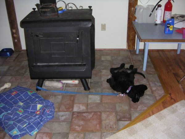

    I first came to Alaska first in 1987 and left in 1994 as a member of the Air Force. I returned again in 2001 and retired from it in 2004. I continue to work full time though I am nearing retirement. Attached is a picture of the old Earth Stove in the house I bought in 2003 (also my Newfoundland puppy Beauty, who lived 8 years, sigh!) I used that old stove for about 12 years. It was a smoke dragon as they say but produced a lot of heat. I finally replaced it a couple of years ago with a higher efficiency one which cost me about $1200. I still have an earth stove I use in my detached garage as supplemental heat in there.
    My experience with the fire brick is it lines the bottom and extends up about as high as the wood is stacked. It protects the metal and refracts the heat for hotter fires. In fact, in my current stove, the manufacturer does not recommend stacking the wood above the level of the fire brick.
