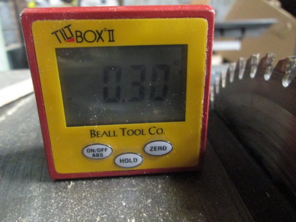

    I have been looking at digital inclinometers in tool catalogs and bought the Tilt Box 2. This small digital tool can be set on saw blades and tool tables to set any angle. It has rare earth magnets on three sides to hold securely to the tool or blade. It has a "zeroing" feature to begin setting the angle.

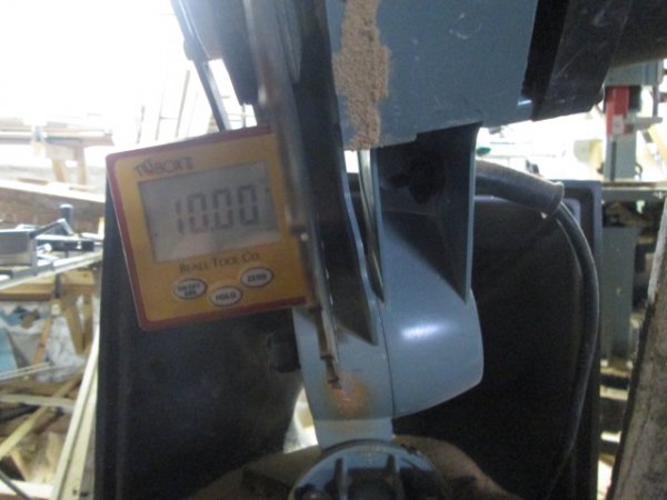

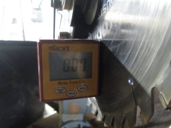

    This picture shows my chop saw is not level to the floor, which is no big deal. I zeroed it in to level and then checked that the blade is perpindicular to the table.
    After zeroing out on the base. No adjustments needed. Over 10 year old Porter-Cable with thousands of cuts under its' blade.
    Test on 10 degree angle on the chop saw.

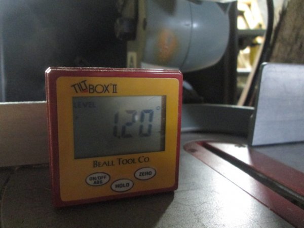

    Table saw before zeroing out.

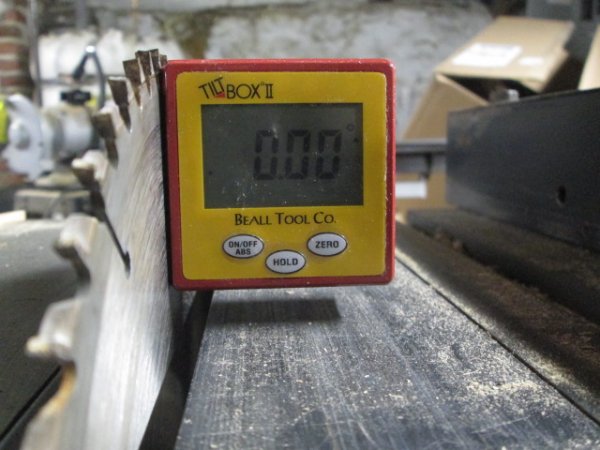

    Tilt Box on saw blade to make it perpindicular to table. It must be set to just below the saw teeth that protrude a little more than the width of the body of the blade.

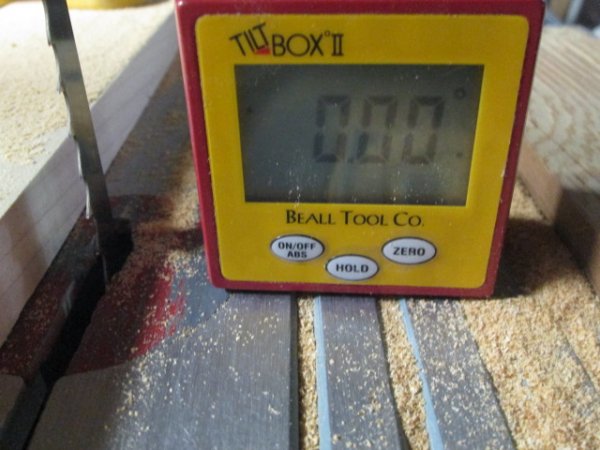

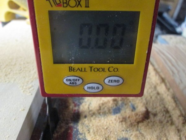

    Lastly, the band saw has a fixed blade and the table tilts for the angle. Zeroed out stuck to the side of the blade.
    Table set to level from the blade. This is excellent for re-sawing boards as the perpindicular cuts reduce passes through the planer to finish them off. Less planer time is a good thing.
    Overall, this tool is very good. I have only used it for a few days, but for what I have seen, it works well.
    I highly recommend it to anyone that wants to have accurate angles.
