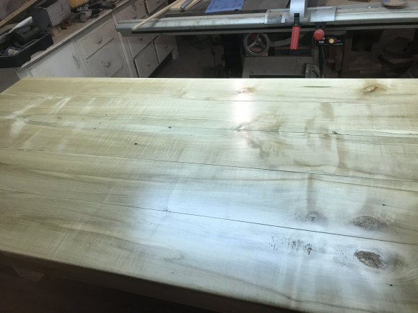

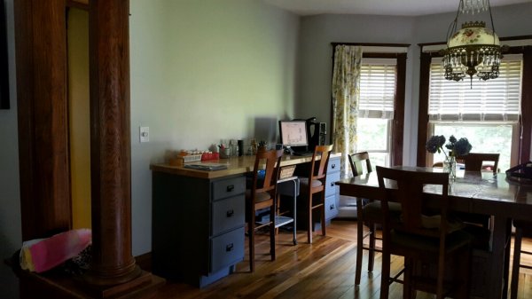

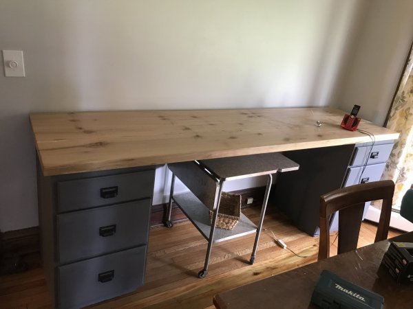

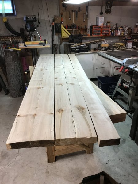

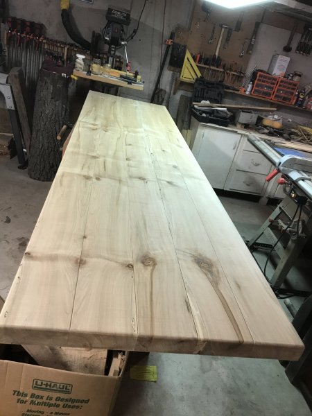

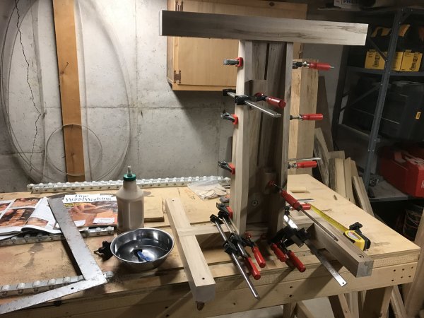

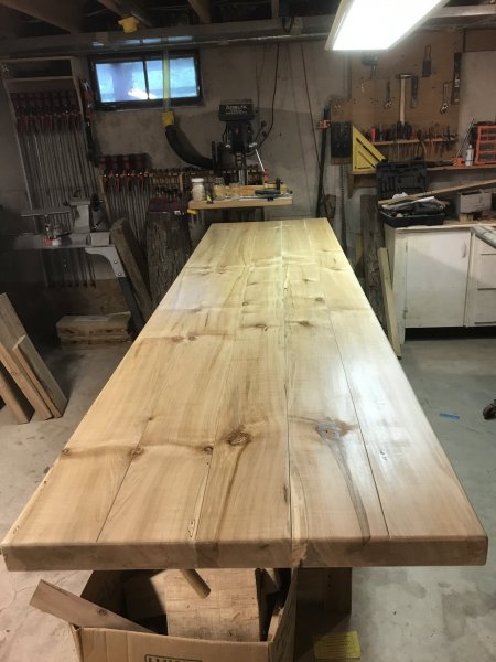

    Ive posted a couple teaser pics of this in other threads. Anyway here's the whole thing. I made it for one of the bartenders at the pub - the place I made the restaurant booths for. It was sort of a "saw it on pinterest" type of job.

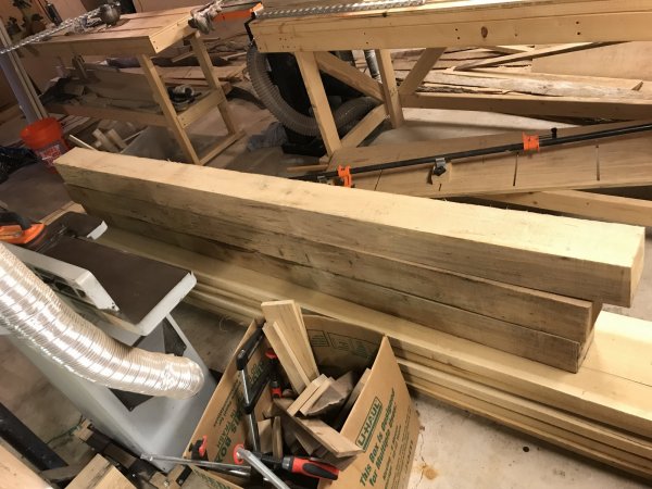

    I started with some of my homemade maple: 4x6's resawed, cause that's what I had available. It all came from the same log and matched up nicely. Dewaxed shellac and wipe on poly for the finish.
    IMG_1460.JPG IMG_1509.JPG IMG_1534.JPG IMG_1576.JPG IMG_1578.JPG IMG_1585.JPG IMG_1616.JPG
    They want a couple of shelves to go with it now too.

    Looks great man! nice JOB :thumbs:
    That has some real nice character

    Beautiful desk. It is a shame to put anything on it to cover the top up. The shelves will be a great compliment to the desk.

    Do you just glue up or biscuit those board edges when assembling?

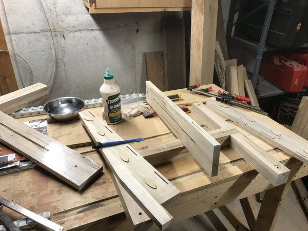

    No biscuits - the only time I really use those is in a corner glue up. In that case it's difficult to apply much clamping force without the joint slipping, and the biscuits prevent that.
    But in the case of a normal edge gluing situation, I find it's better to just work quickly and get the clamps on ASAP. It only takes a few mins for the glue to begin to set and if it does the joint will not close tightly.
