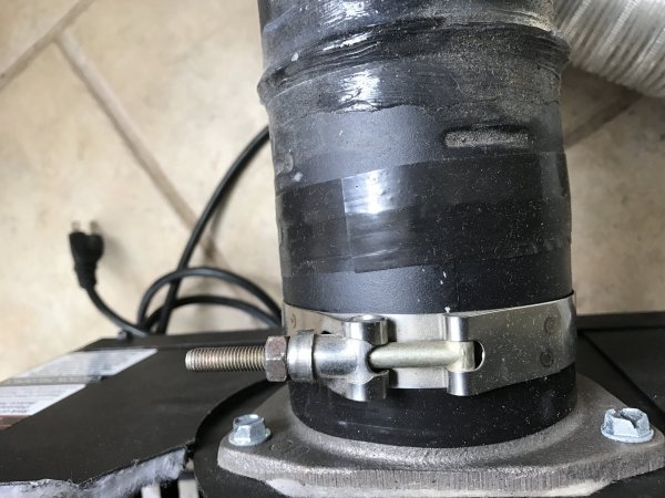

    Is anyone else using one of these to secure their venting to exhaust stub. Makes removal a breeze. I seal the joint 1st using silicone tape and then secure it with the clamp. Just finished my 1st season with it. Love it

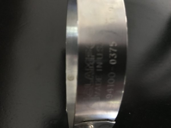

    Corkman thanks for the tip, I could use one of these for the P43. Exactly which size clamp are you using? I will pick one up for this next season.

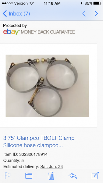

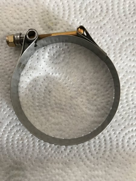

    I got them on eBay. I believe it's 3.75 but I'll confirm when I get home later

    Here we go

    Sellers name is "silicone coupler"
