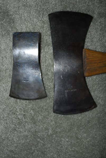

    I bought both of these a few months ago.... 002.JPG I finally got around to cleaning up the small single bit today but there's no makers stamp on it? it's seems to be very nice steel and it has a nice ring to it. I know that the DB is a Hults-Bruk.............HELP?

    can't help with the maker but that's a nice head and almost certainly fine steel.

    X 2......nice looking heads

    My best guess is gonna be GB , Whetterlings , Hults Bruks or Sater Banko .
    A lot were brought into North America with no makers mark .

    Hults Bruks...excellent steel
