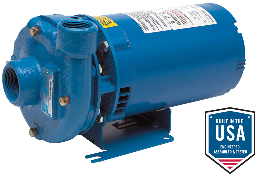

    My previous home (granted we had unlimited city water) looked more like this
    with the 50 gal pressure tank beside it that looked like this
    This house we use a lot less water. We are running about 30 psi now, enough to please the computerized dishwasher and clothes washer but not wasting water when using the sinks/shower. Ideally we'd like to eliminate all the crazy adapters....
