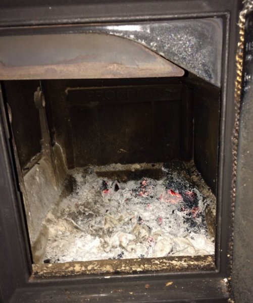

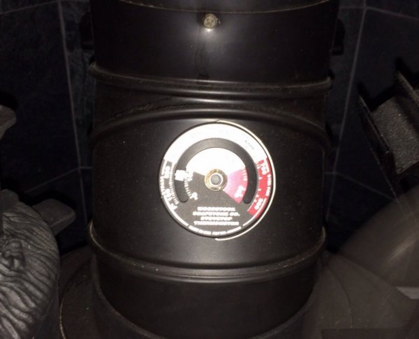

    I just reloaded a small load, it's upper 40's tonight, and going to be 50+ in morning, so not much heat needed. Anyway, here is the reload process I find that works best, it starts quick yet allows a slow burn. Stove pipe was at 200-225 for reload, here's ashes when door was opened:

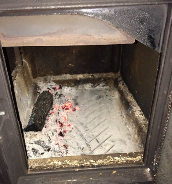

    Now I raked the coals until all the ashes fell thru grate, and then raked the hot coals left all to the front:

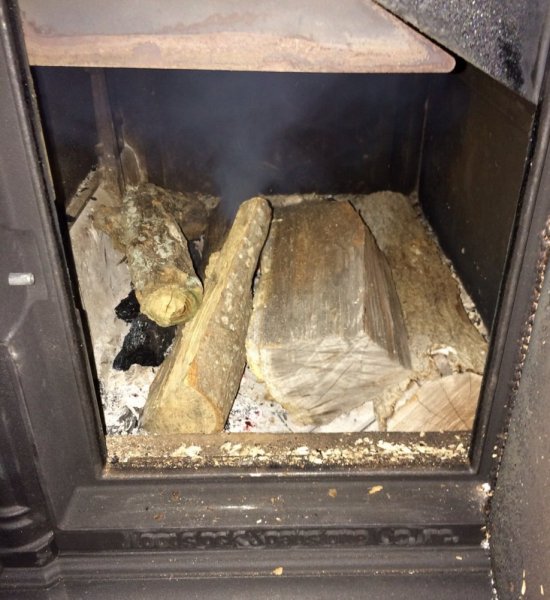

    What reload looked like, largest split in back (although all small splits on this small load):

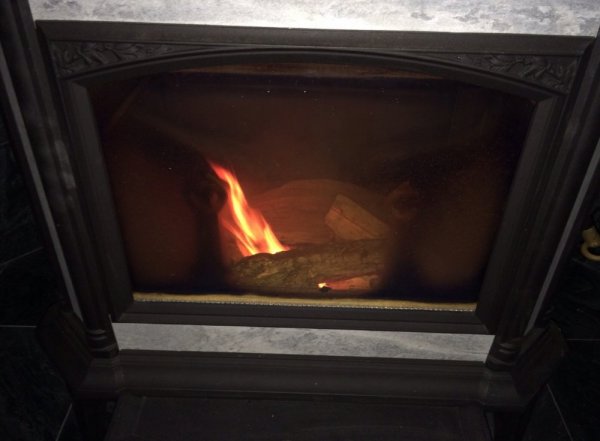

    And what fire looked like after 3or 4 minutes when pipe hit 250 and I shut it down:
    This will burn till 8 or 9 am. Load was at 11 or 12pm
