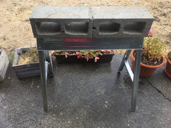

    Hey guys I have to tell you I got a date and while that's kinda not the point, it's the grill I'm hoping to build but need a bit of critique.
    Anyways she's open to trying new things and I wanna set something up that is simple with purpose. So if any of you know what yakitori is, its food cooked on those small grills that are not much wider than a shoebox. So my plan is to get the sawhorse out and put a couple cinderblocks on top. Then Im thinking I just might grab some firebrick at my local TS shop and lay that on top then some on the sides upright. After that get some angle iron and cut to size and put one on each brick 'wall' to hold up the skewers. Just wondering what you guys think, Im just placing firebrick on top so the cinderblocks don't blow. IMG_3258.JPG

  6. lukem
    7,846
    29,699
    I would just stack some firebrick. Make sure you leave a gap for airflow in from the bottom. Traditional yakitori cooks super hot and super fast.
    You can make your own hardwood charcoal very easily and it would be great for this setup.
    Another idea would be to make a big charcoal chimney starter and cook over it.
    FatBoy85 and blacksmith like this.
  7. Highbeam
    Highbeam
    Jun 25, 2014
    747
    1,733
    Cascade foothills, wet side of WA
    This. The regular old stainless steel chimney gets hotter than Hades on top. It's almost like a forge. Lay anything over that torch of flame and it will be seeing very high temps. Searing tuna, steaks, or that funny sounding yakitori. No need to try using a cinderblock that doesn't seem to be able to let air in under the flame.

  8. Jon_E
    Jon_E
    Mar 11, 2015
    636
    2,891
    Southwestern Vermont
    yakitori | l k t c
    To take this one step further, either notch the sides of the block or drill small holes with a hammer drill to allow some air in, or put the top block on some spacers (or maybe an old cake rack?). This is simple enough that I'm going to try it myself at home. We gonna do DIY kabob night.

    So this is all the step by step set-up. Starting with the metal sawhorse and then the cinderblocks.

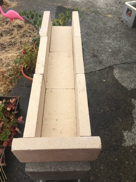

    Followed by the firebrick, bought these at TSC, 10 of them. My intention was to line these in the wind coming from the SW and getting channeled into the brick so I can easily keep the fire hot. With this I realize I can do more than just cook what I am planning to, this just helps bring my idea to fruition that I don't need a welder and anyone can copy this. Most yakitori grills are just metal but they require the food to be cooked over high temperatures close to the fire for the umami flavors.

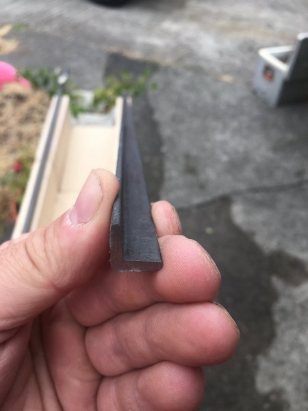

    Here I bought also some angle iron. This is 36 inch long 1/8 thick. Provides control for food on the skewers. And Ive got a little bit of cooking grate I could potentially use on this later.
    And there you have it. The skewer I put on top is for reference that I wont need to stuff an entire skewer full of meat, just where the cooking is.
    I initially thought about just using brick on my grill but heat and weight don't mix. Will post more photos when this gets to cooking.

  11. lukem
    7,846
    29,699
    Needs some airflow from underneath into the firebox. Right side will run much hotter than the left if not capped too.
  12. Jon_E
    Jon_E
    Mar 11, 2015
    636
    2,891
    That's actually a good thing. Allows fast cooking and a quick sear on one end, move the skewers to the other end for finishing. I like it.
