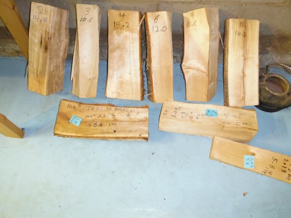

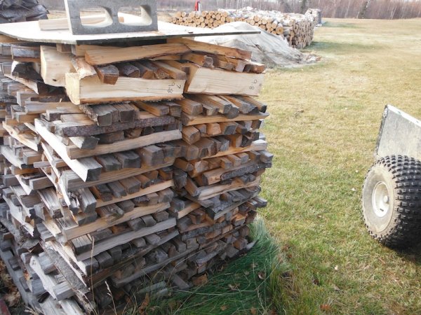

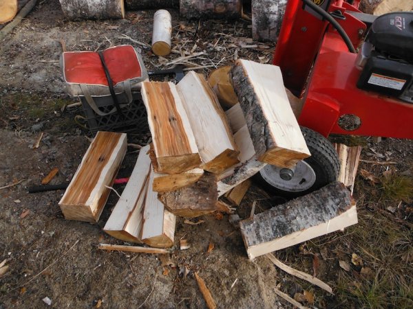

    Fresh off the splitter:
    Weight in pounds
    6 in the basement:
    5 outside (Now in the kindling stack for the fire pit, may move to the birch stack when done S&S'ing)

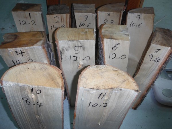

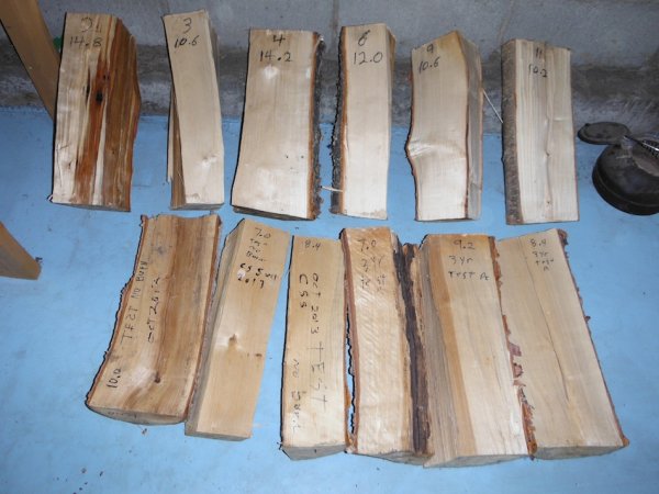

  6. bogydave
    37,208
    WOW
    on Oct 24th, I split & weighed,
    4 days later the inside wood has lost some weight (lbs)
    #2 = 14.8 , now 13.4
    #3= 10.6, now 9.2
    #4= 14.2, now 12.6
    #6 = 12.0 , now 10.4
    #9 = 10.6, now 9.2
    #11 = 10.2, now 9.0
    The 3 left from last year, the weights, no change
    Makes me want to go weigh the outside frozen ones

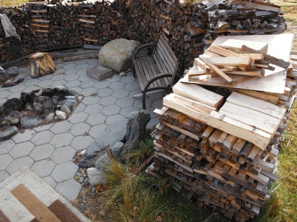

  14. bogydave
    37,208
    Yea, lots of kindling. Spruce.
    Fire pit wood,
    Starting a fire pit fire
    quick to coals in the small section of the pit,
    makes cooking coals for hot dogs & Smore's within 30 minutes or so.
    dylskee likes this.
  15. bogydave
    37,208
    Weighed the outside ones.
    What a difference.
    #1 = 12.2 no 12.0
    #5 = 12.0 , now 11.8
    #7 = 9.8 , now 9.6
    #8 = 9.8 , now 9.6
    #10 = 8.4 , now 8.4
    Being frozen, make a big difference.
    An 80° basement , close to the stove, is the place to dry wood. :)
