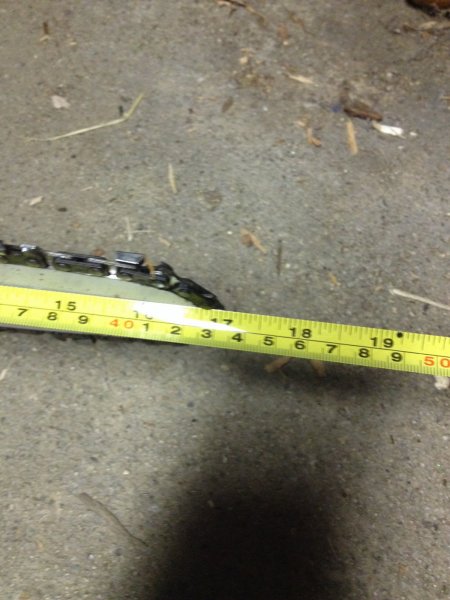

    Here is a quick pic of 18 Stihl bar on my 025. It's only got 17" of usable bar. 3/8 Picco by the way. image.jpg

    That is how all Ms 250's should have came.
