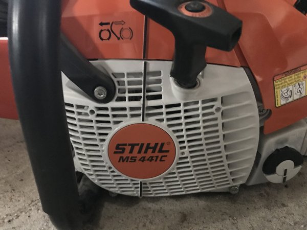

    This just followed me home from my local Stihl dealer with a 6 pack of ultra synthetic gas mix. Stumper and Blacksmith for helping me learn my new saw.

    You are very welcome “Rope” hope you enjoy it. Thank you for reading my Post! Stumper

    I think it will serve me well and earn its keep.

    “Rope did you know that you were buying a saw Sthil has done the most R&D on and it has the new module and the 4701A coil the good stuff. You got a great saw and I like the ultra synthetic oil it is good oil. Make sure you break it in properly. Again congratulations...

    I work midnights and will have time to thoroughly read the manual. Yes Sir, I’m going to take care of her. She will be treated right.
