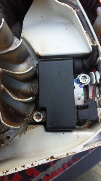

    What is stamped on my coil is 4700. Is the newest and updated coil 4701? And actually I do calibrate the saw after every couple of jobs and I totally clean my saw after every job so it's not a dirt issue.
    The problem with it not starting is random sometimes I take it out of the truck in the morning won't start but other times no problem. Other times I will be running it for most of the day one time shut it off and it won't start again. But I was making hot starts on and off all day! Other days not one issue.

  12. mdavlee
    mdavlee
    Oct 21, 2013
    4,380
    10,478
    There was a 4700A, 4700B, 4700C, 4700D, 4700E, and a 4701A. The E and 4701A are pretty much the same. The others are leaner and turn more rpm unloaded.

    Thanks mdavlee I didn't realize that there were so many coils!:faint: I'll have to pull off my cover and take a picture and post it.

    Here is a picture of my coil. Just in case you can't read the info it says,
    4700 D
    SMT 1504
    What does the SMT 1504 stand for?
    Stumper likes this.

    Original coil part # 1144-4700-c # on coil
    The updated coil# is 1144-400-4720
